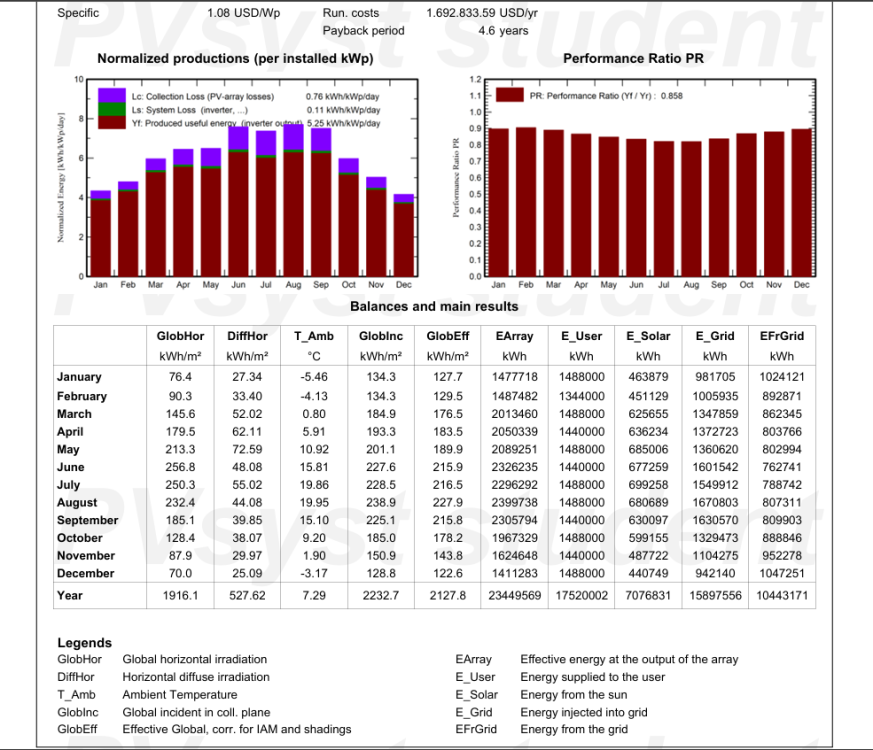

oguzzzzzzz Posted May 20, 2024 Posted May 20, 2024 Is it normal to have this numbers espeacially for E_user This is a 12mw system with 2mw battery
Linda Thoren Posted May 21, 2024 Posted May 21, 2024 Hello, E_User is the Energy supplied to the user and correspond to the load-profile that you have defined. E_Solar correspond to your self consumption, i.e. the energy to the user from your solar installation. EFrGrid is the energy from the grid needed to fulfill the user's load-profile, the E_User. So in this case E_User = E_Solar + EfrGrid, and it seems to be accurate in your results.
