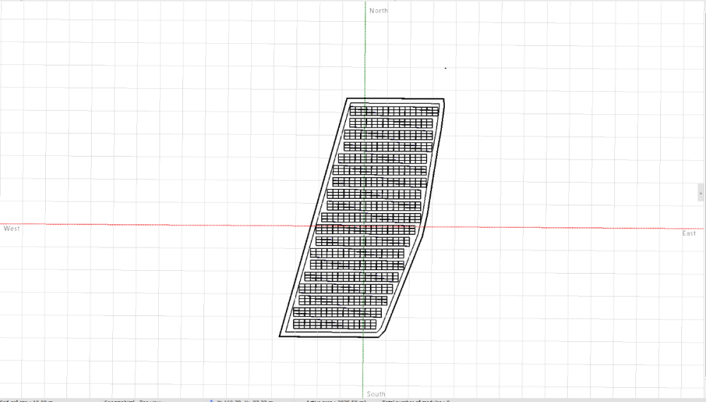

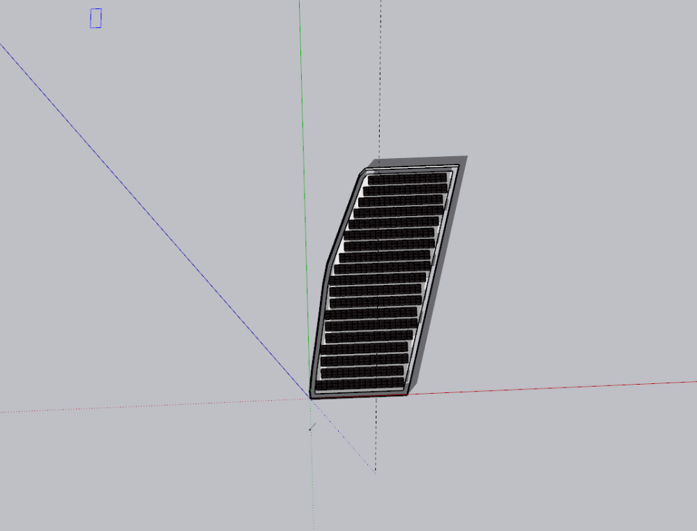

terenceaijei Posted May 18, 2024 Posted May 18, 2024 Imported 3ds from sketchup but opposite orientation in new scene.
Jéremie Bernier Posted May 21, 2024 Posted May 21, 2024 Hello, When you import a 3ds file for data located in the southern hemisphere, you need to check the "Apply 180° rotation" option under 'Rotation around origin' on the Scene details page before validating the 3D scene. Pleae refer to the screenshot in the reply of your other post "Map Orientation".
