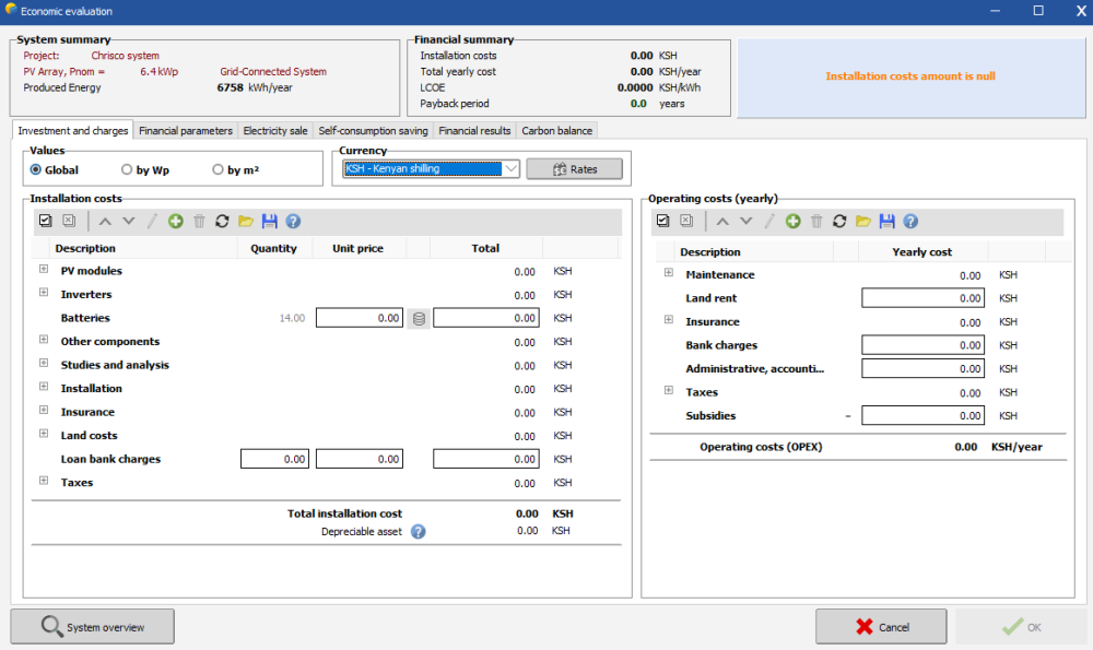

Murtz Posted February 1, 2024 Posted February 1, 2024 Hello I have recently started using PVsyst. I was hoping to find a predefined price list of various components for economic analysis. However, all fields are blank, and I can't find a template or sample document to fill them. I am largely unaware of the various prices, barring a few components. Do you have a solution? Thanks

Murtz Posted February 2, 2024 Author Posted February 2, 2024 Hi Hizir Thanks for your reply. My work is purely academic, so I do not have details on local suppliers. I can surely get some of the component's cost by checking the manufacturer's webpage. However, I will be at a loss in entering number for O&M, installation, etc. Would you have a sample project to share that I can work on? It may not be correct for my case, but it will provide a starting point for me. Thanks
Hizir Apaydin Posted February 5, 2024 Posted February 5, 2024 Dear Murtz, Demo project _DEMO_COMMERCIAL_MARSEILLE available in your PVsyst installation contains the variant VC8 : _DEMO_COMMERCIAL_MARSEILLE_Economic evaluation which has a sample economic analysis. This can be a good starting point for which you want to achieve. Regards.
