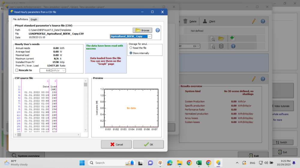

Hello PVSyst, while trying to import a CSV file with a 15min load profile I receive the below error message "Incomplete data: ...". How can I fix this ?
Posted (edited)
Edited by rangsarit
Dear rangsarit,
Importing a CSV file with a 15min timestep is possible as long as you follow the required format, PVsyst will automatically convert this into hourly values for the simulation. In the case of a warning message of “Incomplete data”, it means that data is missing or cannot be read at certain time periods, but you can still run your simulation for the dates available. In the screenshot provided, it seems like your file has not been read correctly given the “Hourly User’s needs” table and the "No data" in the Preview.
Please send your CSV file to support@pvsyst.com and we can try to find the problem.
