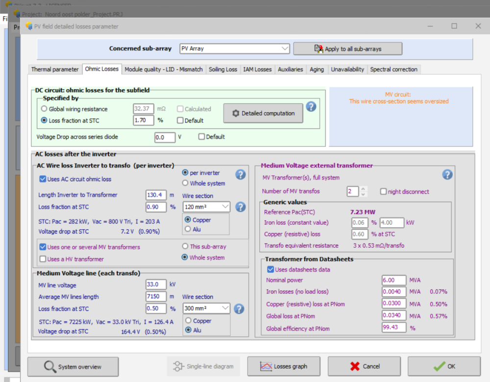

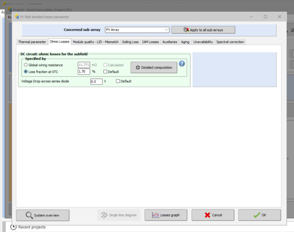

Niels Posted October 5, 2023 Posted October 5, 2023 (edited) Hello, I was going through my older simulated variants for a certain project and I couldnt open my report because i got an error for the transformer nominal power being far higher than the maximum output power of the inverter. After looking at the screen for the ohmic losses i saw the following: (first screenshot) For some reason the ohmic losses for the AC and trafo losses have disappeared? Its only for this specific pvsyst, at other pvsysts I still have my normal losses. see below (second screenshot) Please advise on how to continue, its unacceptable to loose results in such a way. Edited October 5, 2023 by Niels images were hyperlinks
André Mermoud Posted October 18, 2023 Posted October 18, 2023 Probably your second screenshot corresponds to a stand-alone system, where the AC losses are not defined.
