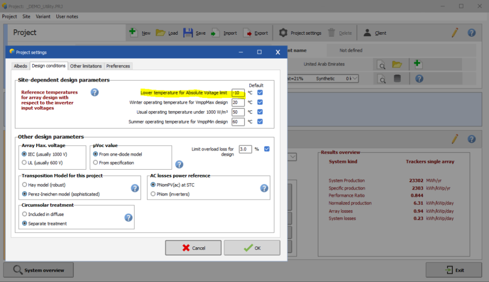

hi sir i am changing the Toper to -5 so i can increse the module number but when i put the in module edit section and press ok it does not change
Hi,
On the "Basic data" page of the PV module's definition, the frame "Internal Model result tool" allows to display the main electrical characteristics under chosen operating conditions. This tool is only informative. It doesn't hold any parameter for the definition of the PV module.
To change the threshold that triggers the error message, go to Project settings, Design conditions, see below
