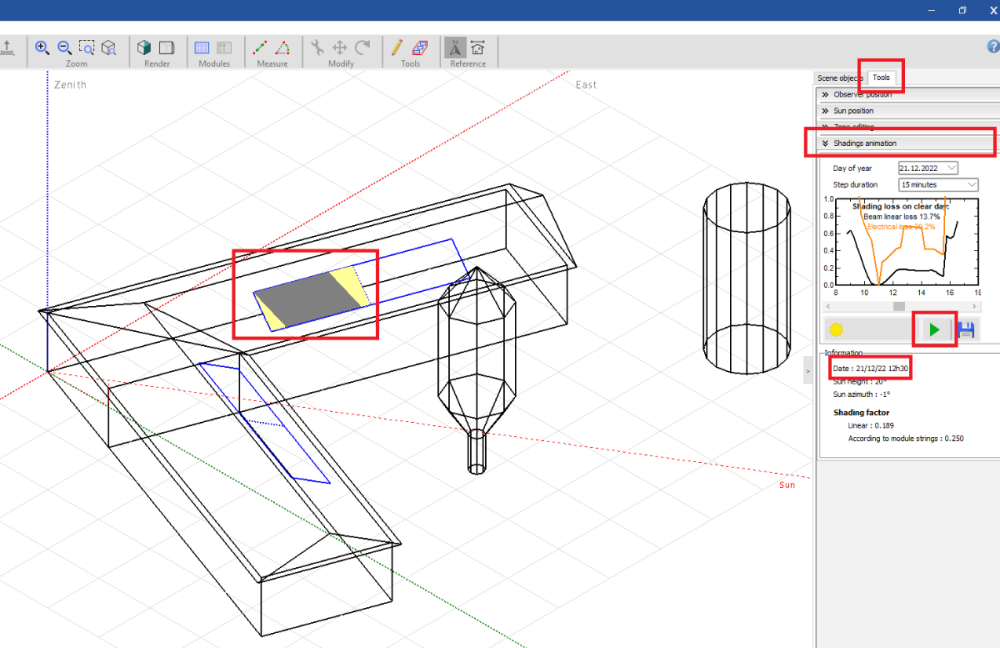

Andreza Maranhão Posted August 2, 2023 Posted August 2, 2023 Is it possible with the use of PVSyst to clearly know the modules/strings affected by shading with information such as: size and location of each shading object and the time of day that this occurred?
Hizir Apaydin Posted August 3, 2023 Posted August 3, 2023 Dear Andreza, With the shading animation tool you can see the progress of shadings on your panels during a specific day of the year. If you have defined the table partitioning in the 3D scene or the module/string attribution in the module layout, you will see them on the animation. Regards
