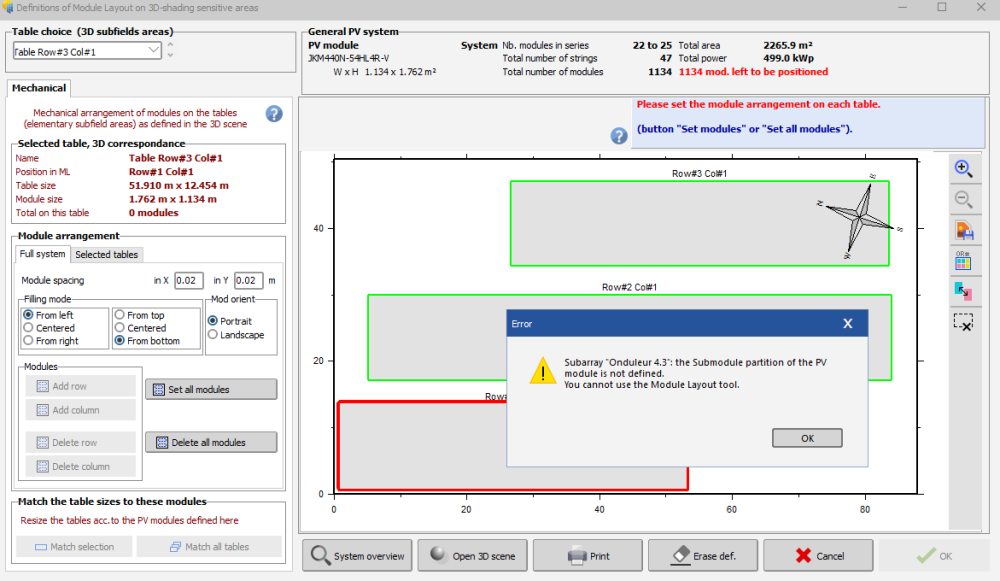

Since the latest update (7.4), I have the same error message in each projects that I did : "Subarray "Onduleur 4.3" : the submodule ... is not defined".
In 7.3 my system and my near shading was good and I defined the partition without problem. I don't know how to solve this error, I checked the lastest messages in this forum and in the update description but I found nothing that can help me. As I said it's not only this one but all of my project. Do I miss something about it ?

Is the PV module you are using in subarray "Onduleur 4.3" different than the one used in other projects / other sub-arrays ? The message is suggesting that there is an issue with that PAN file. If you are not sure you can send us the file at support@pvsyst.com
