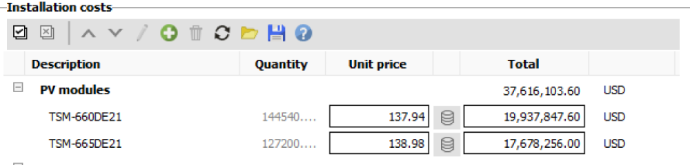

Posted (edited)
Hi Hizir,
Understood the mechanism and I can insert the right price for each panel, then it calculate the whole array's price correctly.
But if I change to mode "by Wp", the price for each panel (USD/Wp) is not correct.
You can see my attached photos (and try yourself with 02 different panels in one project):
- Panel 660Wp: 137.94 usd/pcs (0.209usd/wp)
- Panel 665Wp: 138.98 usd/pcs (0.209usd/wp)

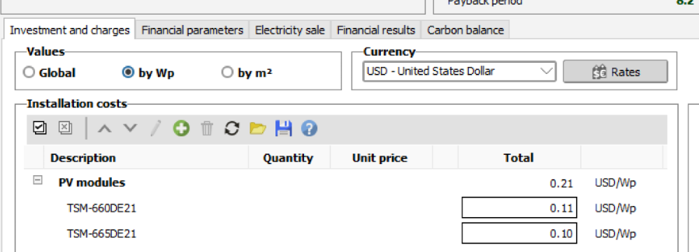

Switch to "By Wp" mode, the total value is still correct, but the component price is displayed wrong:
- Panel 660Wp: 0.11 usd/wp > wrong.
- Panel 665Wp: 0.10usd/wp > wrong.
We can still make it correctly by insert price to the panfile, but I think you guys should check and fix this in the next version.
