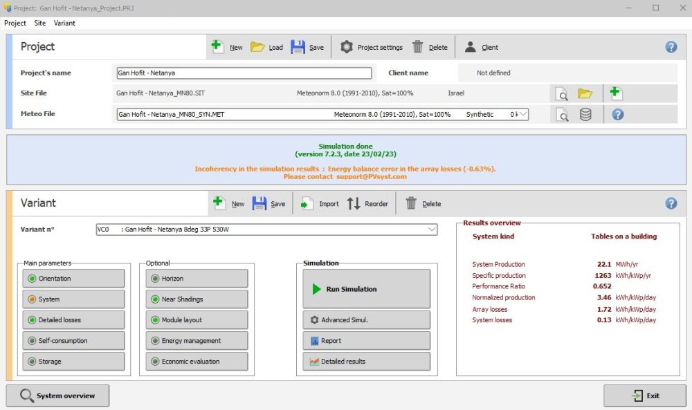

NoamD Posted February 23, 2023 Posted February 23, 2023 Hello, I am receiving an alert message in one of my simulations. Has anyone experienced this as well? would be happy for advice. Thanks,
Michele Oliosi Posted February 27, 2023 Posted February 27, 2023 Hi @NoamD, Thank you for the feedback. In this case, I see that the simulation version is 7.2.3. There have been many corrective patches since then, so I would strongly suggest you update to the latest version, or at least to the latest version 7.2, i.e. 7.2.21. This will allow you to obtain more accurate results, and I believe this specific warning message should be resolved.
