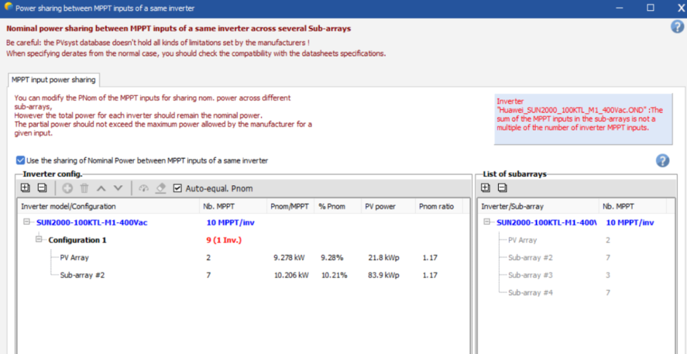

fot Posted January 28, 2023 Posted January 28, 2023 Ηi!! I have a problem related to inverters and power sharing. In the simulation of this specific park we have: 10 inverters 10 MPPT each of them Either 8 or 9 strings with 20 or 22 modules are connected to each inverter I tried to handle it through power sharing and configurations, as seen in images 1 and 2. However, PV syst does not accept an empty input to the inverter and thus, an error occurs. How can i handle this situation? Thanks in advance.
dtarin Posted January 29, 2023 Posted January 29, 2023 Modify the ond file and reduce the number of mppt inputs. Save this as new file.
