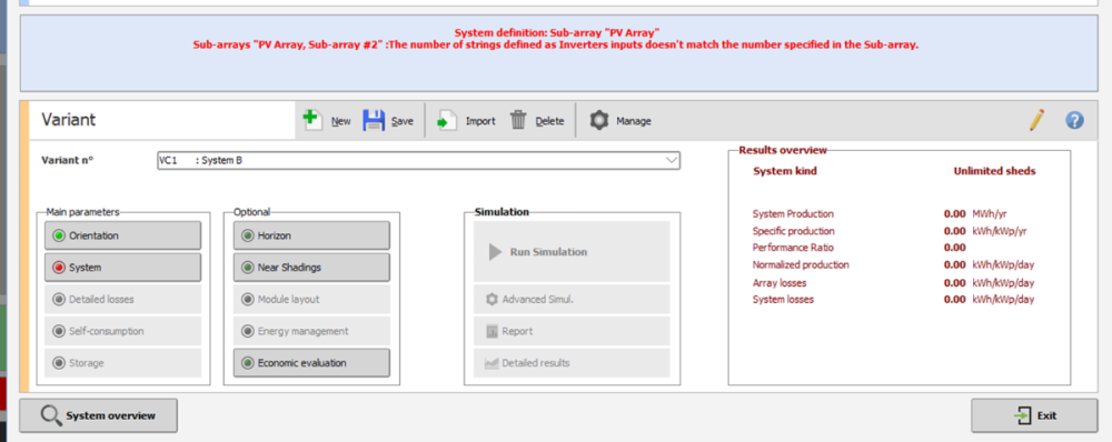

I noticed this error coming up repeatedly even after fixing the error, whatever changes I had done disappears when I switch to another variant or close the project.
Step 1/ Pic 1: Designed a system with SolarEdge inverters, I had to fix the unequal stringing to get the right system size
Step 2: Fixed the stringing and pvsyst error was gone. Saved the variant, run the simulation and generated report.

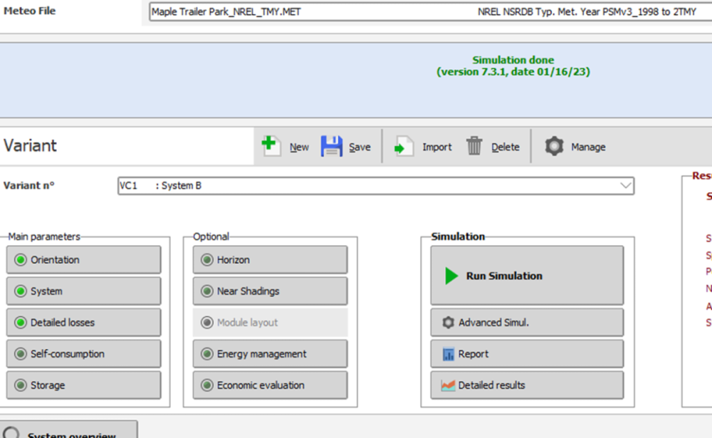

Pic 3:
After this I'm getting the same error, and the changes I had already finished disappears after switching variants or closing the project. and I'm certain whatever changes I have done was accurate.
Not sure if this error is known but couldn't find anything in the forum related to this. Also, I tried opening a project that was done a year ago and saved, is not working in this version 7.3.1.
I don't know. We have never been contacted about this error.
Please send us   (support@pvsyst.com)  the whole project, using "Files > Export projects" in th main menu, and explain the exact way of getting this problem.
