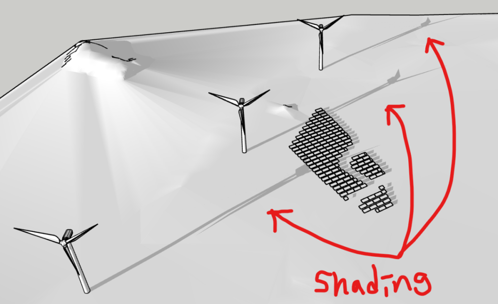

sujinlee Posted January 6, 2023 Posted January 6, 2023 Hello. I'm using pvsyst very well. When I want to know the amount of power generation, there's a shadow around the terrain like a wind generator, Can't you insert this into the 3D module layout to obtain the amount of power generated by shading? Drawing obstacles in SKETCHUP does not run import into the 3D module layout.
dtarin Posted January 6, 2023 Posted January 6, 2023 Go to create > elementary shading object. Wind turbines are available, as are other objects. If you need something specific, you can either build it piece by piece or use an approximate shape.
Stéphane Metz Posted January 6, 2023 Posted January 6, 2023 You can also import objects from Sketchup in DAE or 3DS format, by default all imported objects are considered as obstacles, and will generate shadows.
