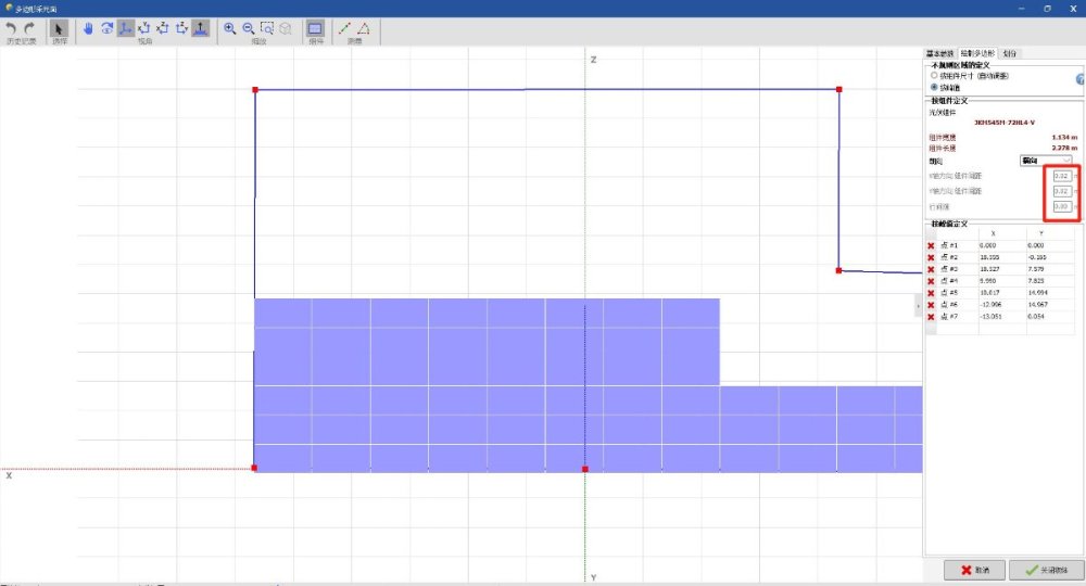

sunway Posted October 28, 2022 Posted October 28, 2022 请看图片,红框内的参数不能输入,在我自定义了光伏区域之后,以前的版本可以设置的,建议恢复这个选项 If you can't read Chinese, please email me:sunway2563@gmail.com
Michele Oliosi Posted October 31, 2022 Posted October 31, 2022 Hi, Please provide your question in english if possible. The language of the forum posts is in english (see forum rules). You can send us your questions at support@pvsyst.com you can turn on these settings by clicking on "by modules (adjust sizes)"
sunway Posted October 31, 2022 Author Posted October 31, 2022 1 hour ago, Michele Oliosi said: 你好, 如果可能,请用英语提供您的问题。论坛帖子的语言为英语(参见论坛规则)。 您可以通过 support@pvsyst.com 将您的问题发送给我们 您可以通过单击“按模块(调整大小)”打开这些设置 thank you
Michele Oliosi Posted October 31, 2022 Posted October 31, 2022 If you click on "by modules (adjust sizes)" instead of "by summits" you should be able to change the module spacings.

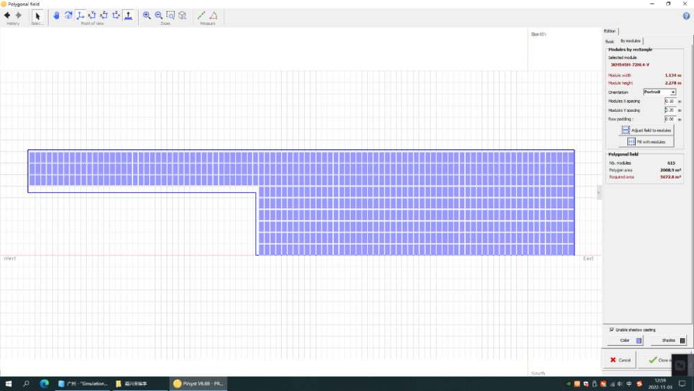

sunway Posted November 3, 2022 Author Posted November 3, 2022 On 2022/10/31 at PM6点11分, Michele Oliosi said: 如果您单击“按模块(调整大小)”而不是“按峰顶”,您应该能够更改模块间距。 I usually customize an area according to the actual boundary, and place photovoltaic panels within this area. If I use the method you mentioned to place panels, I can only click one by one with the mouse. This is the difference between the new version and the old version

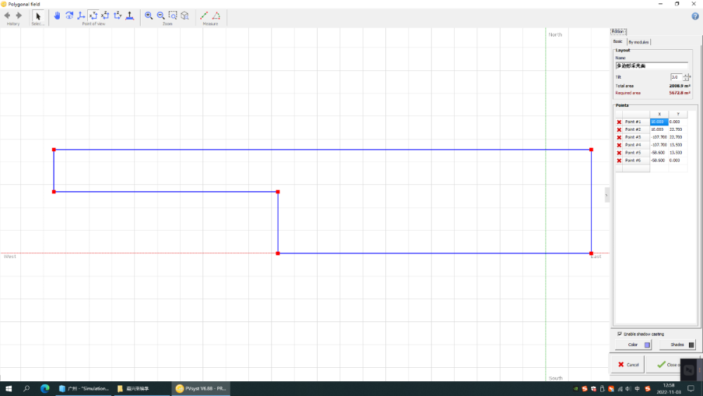

Michele Oliosi Posted November 3, 2022 Posted November 3, 2022 At the moment the workaround is to switch directly to "by modules". Adjust the spacing. Go back to "by summits" and redesign the polygon. I have submitted a ticket to improve the functionality at some point in the future.
