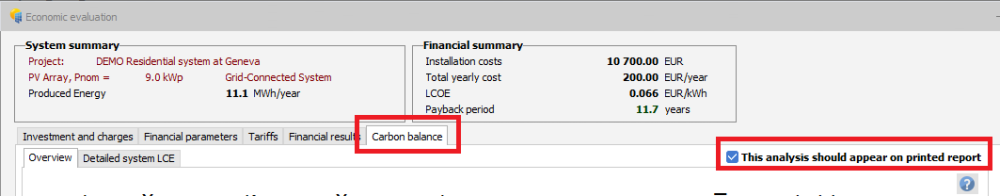

Thet Posted September 14, 2022 Posted September 14, 2022 CO2 emissions balance page is included sometimes in my report but not included sometimes when I simulate.where could I check its parameters ?now I am using v7.2.18. Thank you ?
Hizir Apaydin Posted September 15, 2022 Posted September 15, 2022 Dear Thet, The Carbon Balance is currently part of the Economic Evaluation tool. You can access it from "Project" dialog, "Economic evaluation" button, then click on "Carbon Balance" tab. You can either choose to print it or not in the final report by checking/unchecking the corresponding checkbox Regards,
Thet Posted September 30, 2022 Author Posted September 30, 2022 thank you for you reply.It work well.
