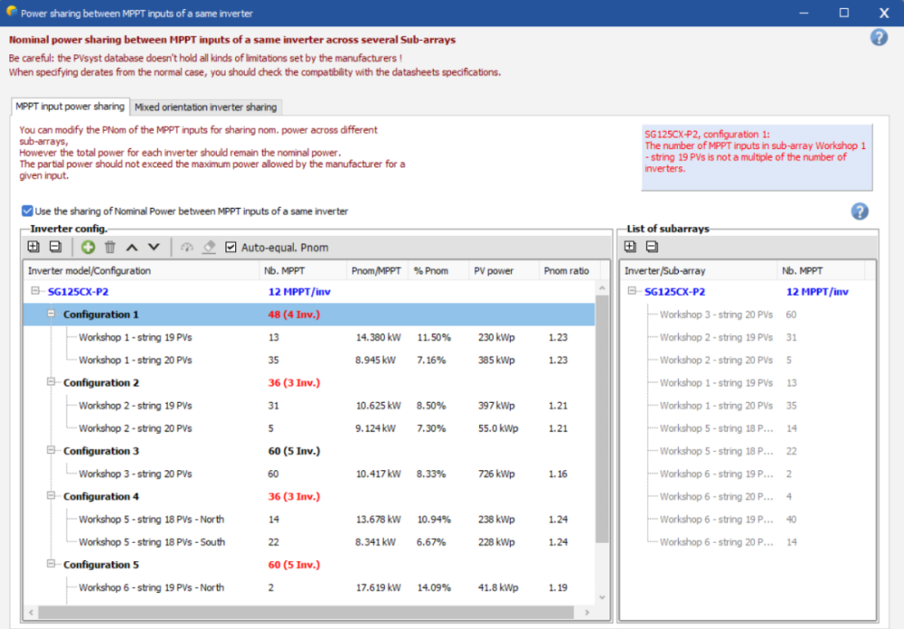

Zeira Alford Posted September 6, 2022 Posted September 6, 2022 Hi, I got another bug that it always remain error message even if the number of MPPT inputs is a multiple of the number of inverters. So I cannot click OK for that.
Manuel Maier Posted December 20, 2022 Posted December 20, 2022 @PVsyst forum Dear PVsyst-Team, is there any update on Zeira Alford's problem? I am facing the same issue. Thank you!
