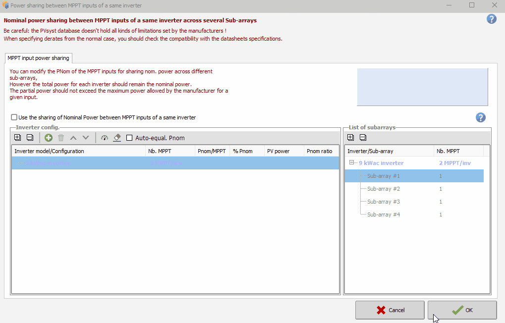

From version 7.2.15 on we have updated the "power sharing" interface. The previous interface, based on radio buttons, was showing limitations when there were many sub-arrays.
In the new interface, one works by drag-and-dropping sub-arrays from the right panel, containing an exhaustive list of sub-arrays arranged by inverters, and the left panel, where configurations by grouping sub-arrays together.
The logic is the same as in the previous interface. One should assign sub-arrays to a same group to balance the power between them.
More details are given in the help page: https://www.pvsyst.com/help/powersharing.htm.
