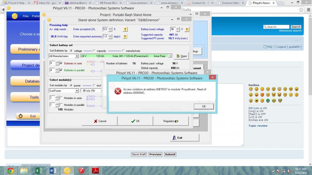

gupta89 Posted September 23, 2013 Posted September 23, 2013 Hi Andre,I have been trying to model a Stand alone system with batteries and Sunpower modules. I am using batteries that I have defined myself. Once I start the system configuration and choose the batteries, everything goes fine till I begin to choose the modules. Access error messages show up like the one shown in the screen shot. Please help me understand how I can get round this problem. I am trying to model my stand alone system's performance.Abhinav GuptaScreen Shot of the error2013_09_23-10_42_26-PVsyst611-logs.zipLog Files
André Mermoud Posted September 23, 2013 Posted September 23, 2013 Thank you for this detailed report of the problem, and the logs. However this is an error that I can't understand from the LOG information. Please tell me: - Doest this problem arise at each of your tryings, or just once ? - try to do the same with another battery model (from de database),- Please send me the whole project, using "Files" / "Export projects/components" in the main menu, in order to ensure that all involved files are present. My address: andre.mermoud@pvsyst.com
