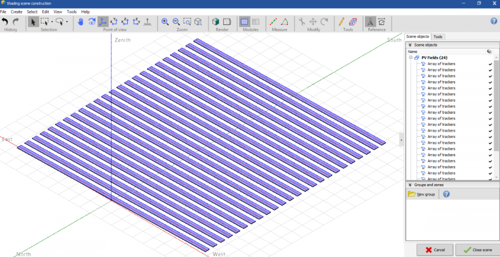

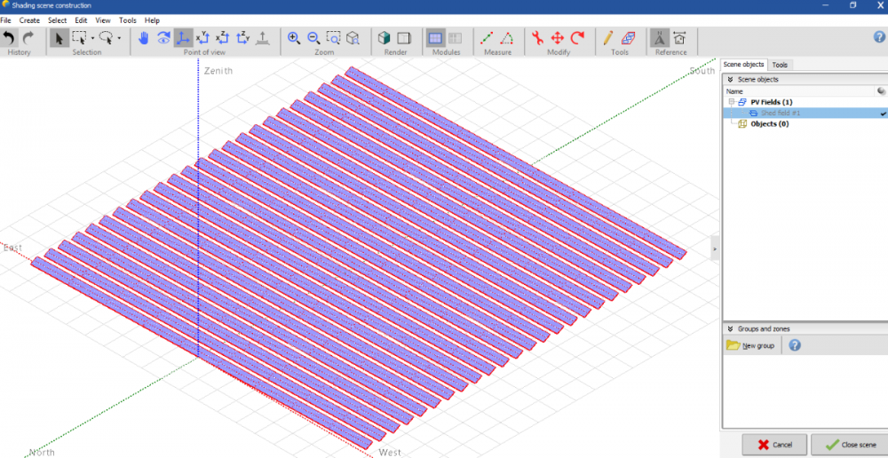

julmou Posted May 13, 2022 Posted May 13, 2022 Hello, Starting with a PV shed field with 24 rows (as an array of tables) -> see first screenshot below, I am surprised that, when I convert the array into trackers (Create > Convert fixed tables to trackers), I get 24 objects each qualified as an "array of trackers" (when really each is a single table), instead of obtaining one single array of trackers of 24 rows -> see second screenshot Am I doing something wrong in the manipulation?

julmou Posted May 17, 2022 Author Posted May 17, 2022 This is not what I meant. I'm okay with the names. I just thought an array of tables would be converted into an array of trackers, and not into single trackers.
Stéphane Metz Posted May 17, 2022 Posted May 17, 2022 OK, I didn't understand that. So currently this is not possible, sorry. During transformation, arrays will always be ungrouped.
