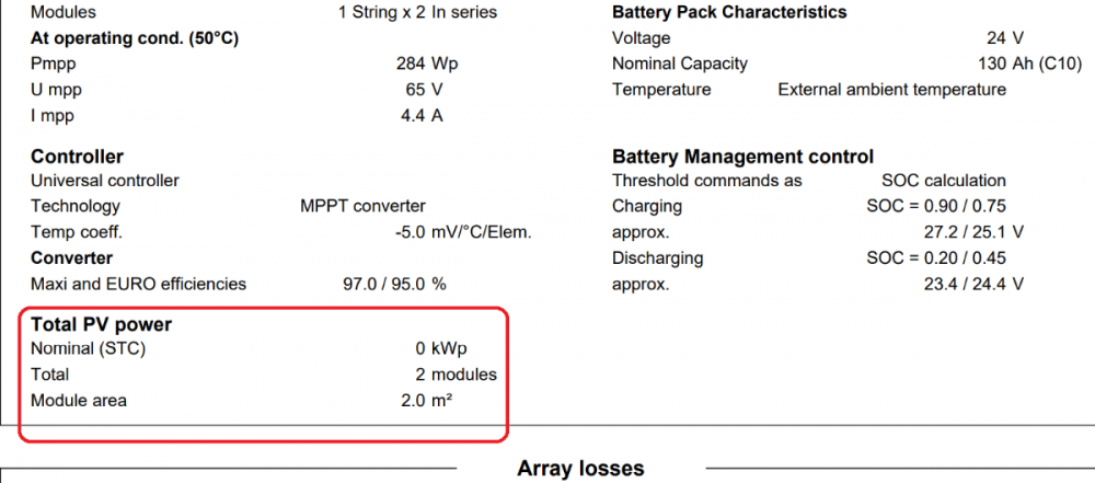

JINU Posted May 11, 2022 Posted May 11, 2022 Hi, Everyone I am new to pvsyst, i am in learning stage. i tried to create a small standalone project of 55W and got results. but when i made report the report shows total pv power as zero. Could you pls help me to sort out this issue. here attached the image of the report.
André Mermoud Posted May 11, 2022 Posted May 11, 2022 This is indeed a bug in the report: the value is shown in kW, without decimal: the real value is around 0.284 kWp (I don't see the real STC value of your modules)

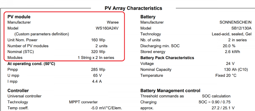

JINU Posted May 12, 2022 Author Posted May 12, 2022 Hi, Andre from where i can check the real value of modules. I am using 160Wp 2 panel in series, which i added in the panel database
JINU Posted May 12, 2022 Author Posted May 12, 2022 In panel characteristics its showing, but in the end of the report 0Kwp, i cant sort out, i dig a lot more into tutorial and found nothing.
Michele Oliosi Posted May 12, 2022 Posted May 12, 2022 You can check the system window: there the nominal power should show up as kWp but with one decimal. As André said, there is a bug in the report. We still need to solve it in one of the upcoming patches.
