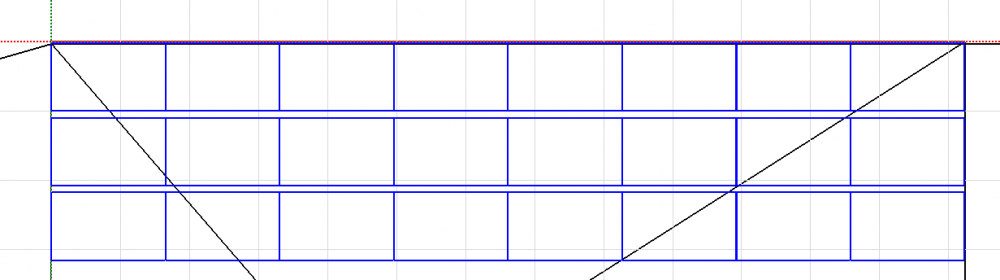

1." The PV field "table Row#1" is confused with or very close to the object "table Row#1 Col#2" such an error occurs. How do I fix it?
2. I want to change the space between PV modules. Is it possible to change? If it is possible, how to?
Actually, If I change the space between the PV modules, I thought, 1stCapture1.PNG.92a423b63dcedb14edc536bdcb074d33.PNG problem will be fixed. But I don't know how to do 2nd problem.
Please help me
Dear Mubo,
1.
Some fields look interpenetrating each other in your 3D scene.
Please export and send your project to support@pvsyst.com for an advanced analysis (from PVsyst main window "File>Export projects").
2. You can modify the space between modules from "Table size" tab of your field object:
