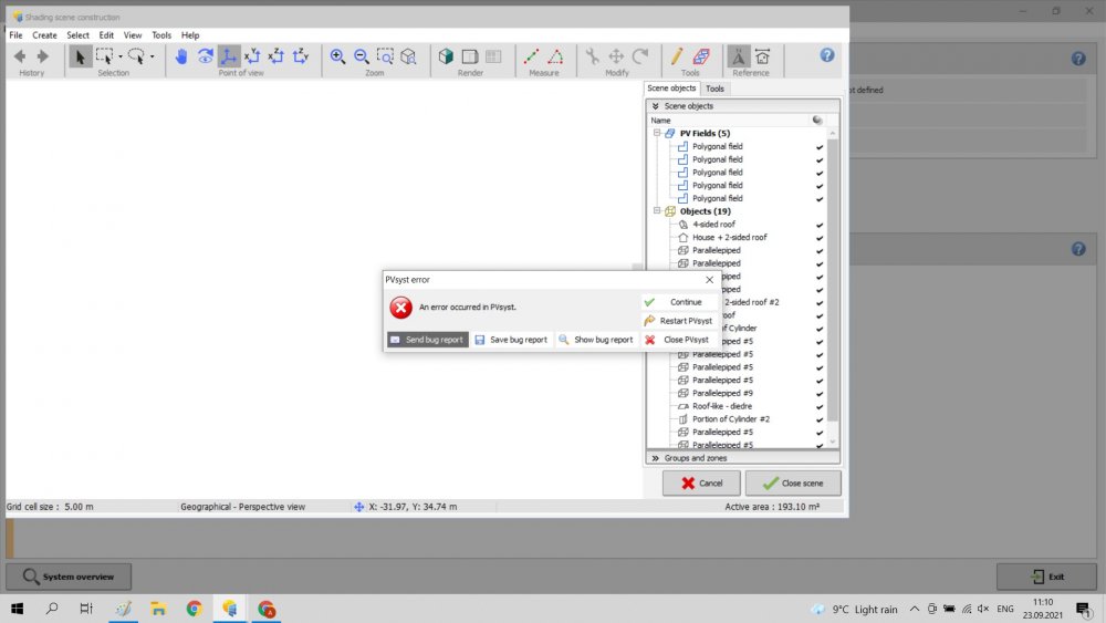

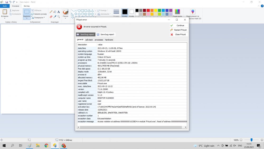

Kateryna Zakharova Posted September 23, 2021 Posted September 23, 2021 We've just updated our PV SYST to V. 7.2.6.22690. After that, we tried to open the shading scene of the existing saved project and got an Error window (see it attached). Also, you can see bug report below. How can we fix it???
Hizir Apaydin Posted September 24, 2021 Posted September 24, 2021 Dear Kateryna,There is indeed an issue with polygonal fields in PVsyst 7.2.6 and the fix will be available in the next version.In the meantime, here is a workaround to avoid the error:- Open a project variant that does not contain polygonal fields- Open “Near shadings” dialog- From the top menu, select “View”, “View options”, and uncheck “Show modules”.You will then be able to reopen shading scenes containing polygonal fields.Kind regards
