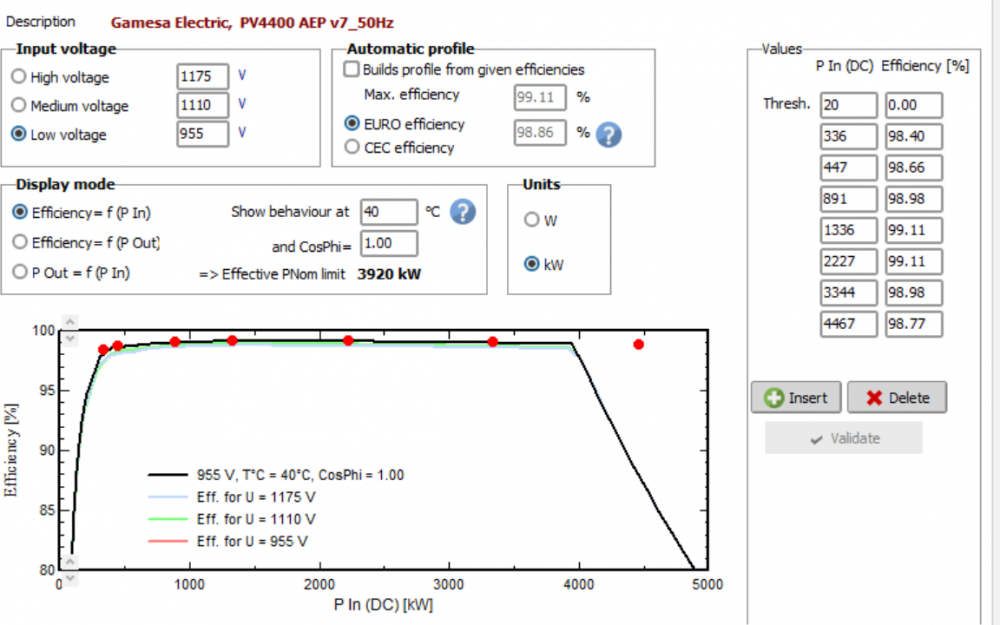

Hi,
Does the PVsyst take into account the inverter euro efficiency in the yield or PR? or does it follow the values interpolated from the figures in the table (Pin(DC) Efficiency [%] and depicted in the graph?
1016332924_screenshotGaEPV4400AEPVDC955.thumb.PNG.e92632bfcf92903f3f806a0af6944c42.PNG

Dear nanuk,
In PVsyst there are 4 ways of defining the efficiency of inverters :
- from a single efficiency curve eff = f(Input power), specified by up to 8 points
- from a single efficiency curve eff = f(Input power), automatically built from the Maximum, EURO or CEC efficiencies and the Power Threshold (Pthresh)
- from a set of 3 efficiency curves eff = f(Power, input voltage), all of them specified by up to 8 points
- from a set of 3 efficiency curves eff = f(Power, input voltage), all of them automatically built from the Maximum, EURO or CEC efficiencies and Pthresh.
Automatic efficiency profiles: this option is used when only the Maximum and EURO or CEC efficiencies efficiencies are available. PVsyst then construct default profiles
You can see the detail here : https://www.pvsyst.com/help/inverter_efficiency.htm
So if you don't check "Builds profile from given efficiencies" it will use the table you see on the right side
