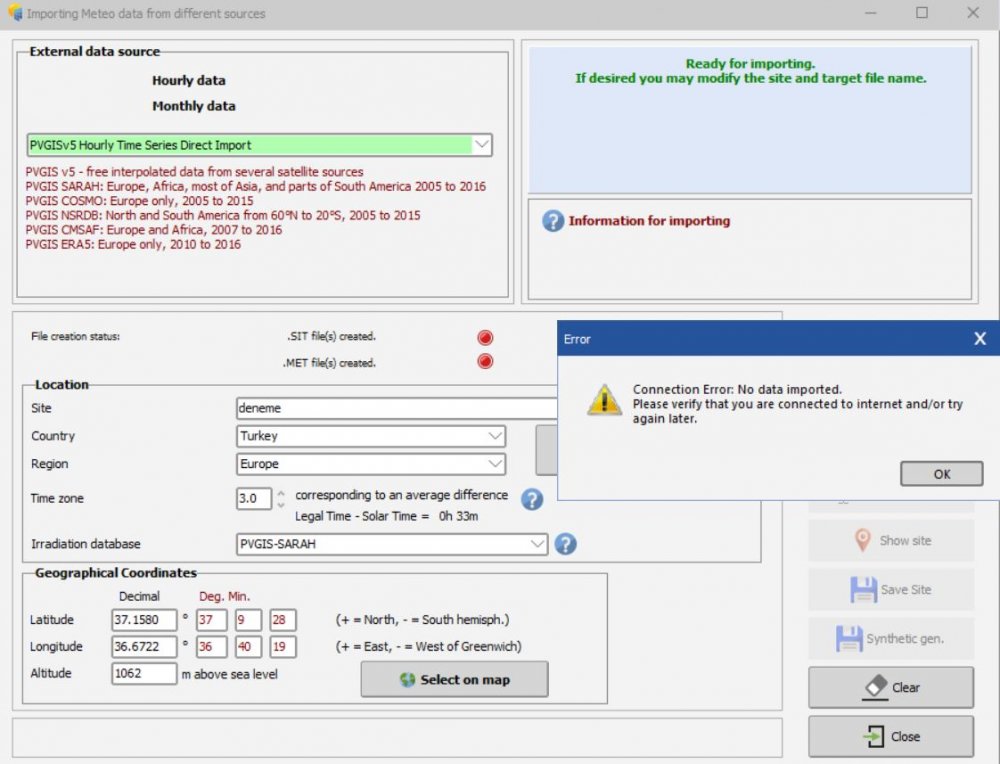

Koray Beyce Posted August 26, 2021 Posted August 26, 2021 Hello,When i try to import PVGIS meteo data to PVsyst, i am getting an error which can be seen below. However, i have noy any problem with my internet connection.Could you help me about this error?Best regards,Koray
dtarin Posted August 26, 2021 Posted August 26, 2021 For issues such as these, include your PVsyst version in your post. I have tested the same coordinates in 7.1.8 and it is working.
Koray Beyce Posted August 27, 2021 Author Posted August 27, 2021 Quote For issues such as these, include your PVsyst version in your post. I have tested the same coordinates in 7.1.8 and it is working. I am using PVsyst 7.1.2.
dtarin Posted August 27, 2021 Posted August 27, 2021 There is nothing in the release notes regarding PVGIS. I would suggest upgrading to 7.1.8 and trying it (https://www.pvsyst.com/previous-versions/).
