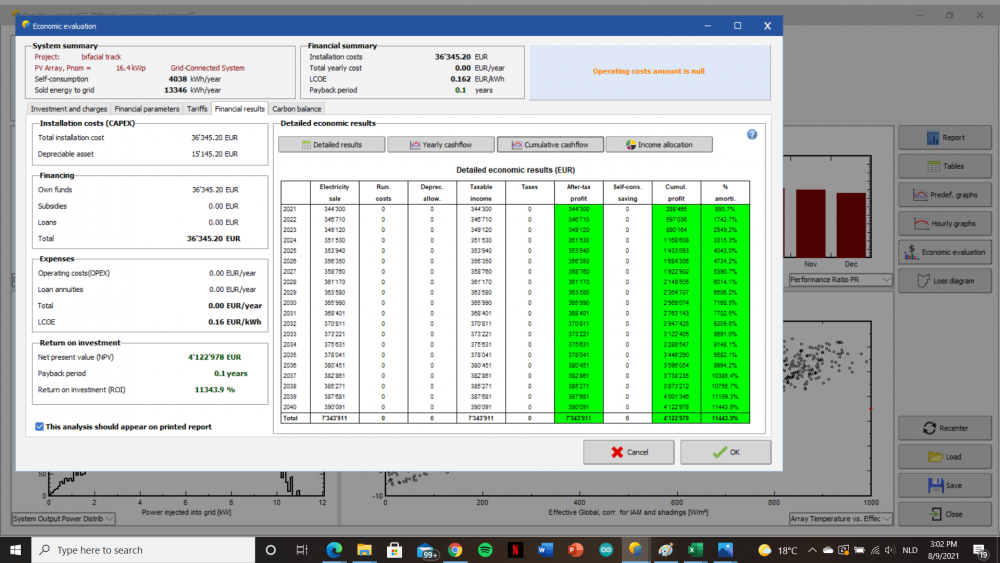

EmmaVanoverschelde Posted August 9, 2021 Posted August 9, 2021 Hello everybodyAs you can see in the picture below, my NPV and ROI are really high, while my payback period is very low. Does anybody knows how it is possible that these values are so high/low? Thanks in advanceEmma
dtarin Posted August 9, 2021 Posted August 9, 2021 Your feed-in tariff is too high, unrealistic price of energy.
EmmaVanoverschelde Posted August 10, 2021 Author Posted August 10, 2021 Your feed-in tariff is too high, unrealistic price of energy. We got these values from Belpex, so It's quite accurate... Belpex: https://my.elexys.be/MarketInformation/SpotBelpex.aspx
dtarin Posted August 10, 2021 Posted August 10, 2021 Your feed-in tariff is too high, unrealistic price of energy. We got these values from Belpex, so It's quite accurate... Belpex: https://my.elexys.be/MarketInformation/SpotBelpex.aspx Those are prices per MWh. Check if you entered the correct price per kWh. Electricity doesn't cost that much, so the issue is with your feed-in tariff. A screenshot of that tab would help if there is further doubt.For example, assuming the year 1 production is 13,346 kWh (the energy sold to the grid), your year 1 cost of energy according to your results is 344,300/13,346 = €25.79/kWh. This does not seem correct.
