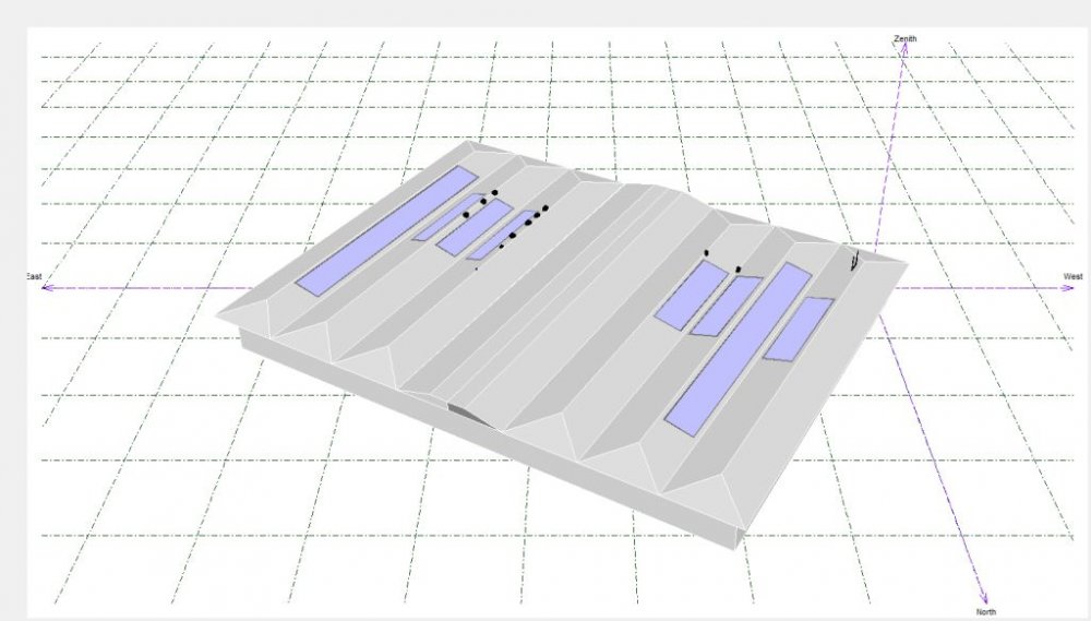

Paul.Rodden Posted July 9, 2013 Author Posted July 9, 2013 I am using version 6.07. I have added a couple of images to help clarify my problem. They show the basic array layout with south-east and north-west orientationsand also system sizing screen. I have tried hetro and single axis options. I accept it may be a user error but I have tried a number of options and the only thing that worked was converting the inverter to a single MPPT versionThe STP 17000 inverter is 2 MPPT's but the new 20000 vesrions is just one MPPT.Screen dumpArray Image
Paul.Rodden Posted July 9, 2013 Author Posted July 9, 2013 Is there some setting that I have missed? is it some bug with my version? ...is worth sending youy the project files (not posting them) or getting the software reloaded?
