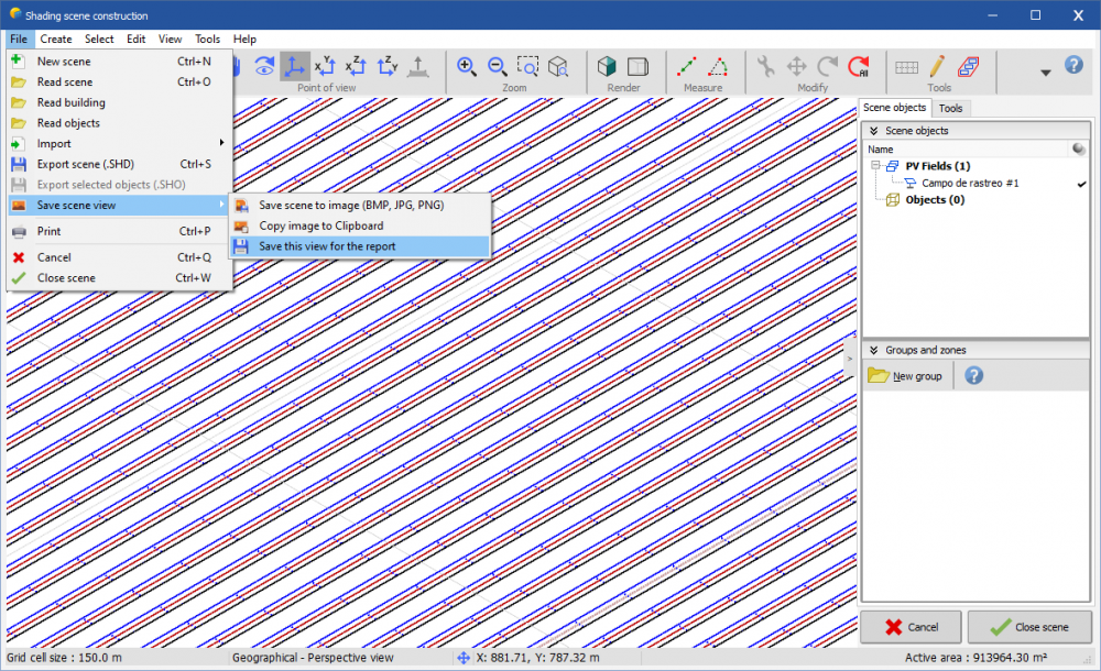

wailsalaoui Posted February 11, 2021 Posted February 11, 2021 Hello, im planing a 6MWp project, and i am wondering how can i make the modules visible in the report. All what i can find ist this blue frame area.
Stéphane Metz Posted February 11, 2021 Posted February 11, 2021 Hi wailsalaoui,In the 3D scene, you can select the screenshot you want to use in the report:
wailsalaoui Posted February 11, 2021 Author Posted February 11, 2021 thank you, and can i make a multiple views or only one?
Stéphane Metz Posted February 12, 2021 Posted February 12, 2021 No, only a single view, this is just an illustration of what your installation looks like.
