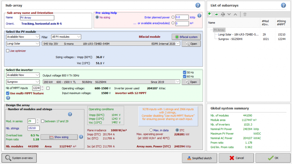

I have a problem with a common configuration: 15 strings per inverter with a 12 MPPT (24 input) string inverter (Sungrow eg). It shows up a message like this : <<9278 inputs with 1 string and 2966 inputs with 2 strings, consider disabling "use Multi-MPPT feature" for ensuring power sharing on each input>>
2 involved problems:
1- It takes 90 minutes to simulate whilst without this Multi-MPPT activation it takes less than 30 seconds
2- It applies more than 9% of overload losses
Is there something wrong? These configurations are usual, as it results quite "lucky" that you can fill out all the 12 MPPT with 2 inputs per MPPT (24 inputs)
Please we need some feeback or related question if you guys need more details

92386618_MixedMPPTconfiguration(15stringsfor12MPPT).thumb.png.30a99ef281fd3084fefb17fa9c954582.png
Hello again, i ve just encountered the solution by browsing the "help". As its name says it can help you :D
Has anyone gone through this issue, I can guide you guys quickly to resolve it, it is really great explained in "Help" options, thanx PVsyst Team for your improvements

The warning message in orange suggests considering disabling “use multi-MPPT feature” for ensuring power sharing on each input. With all the strings being the same there is no need to activate the multi-MPPT feature. In this case, the number of inverters is 1020.3 and thus do not reflect a correctly sized system in reality.
Regards
