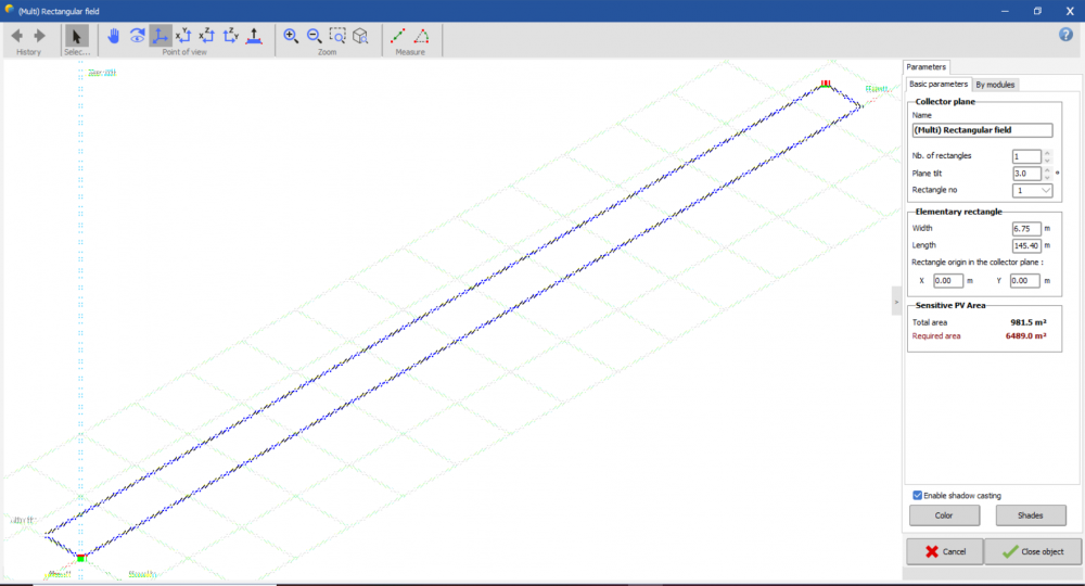

NirWana Posted July 31, 2020 Posted July 31, 2020 Hello,I have a display problem after installing PVSyst7.All characters and lines are blurred.I have attached a screenshot file for you to check.Thank you very much for your help.Screenshot of the display problem

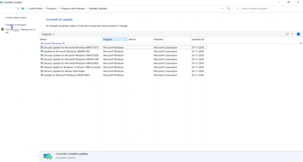

Sylvain Pepoli Posted August 6, 2020 Posted August 6, 2020 Hello,We have identified the cause of the issue, it’s related to a recent Windows update,Could you please check on your computer if you have installed the below Windows update and if so please remove it. https://support.microsoft.com/en-us/help/4497165/kb4497165-intel-microcode-updates Unfortunately Microsoft does not give accurate information about the impact of this update. The only solution for now is to remove it to fix the 3D issue.Best regards,

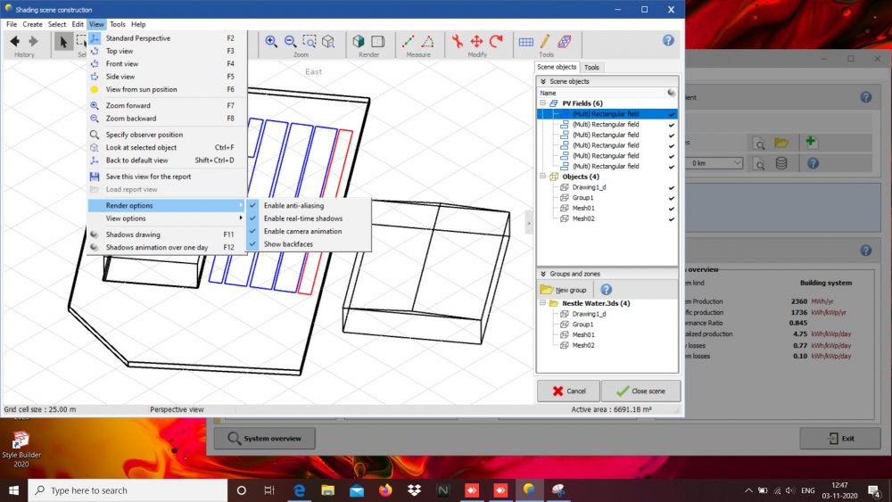

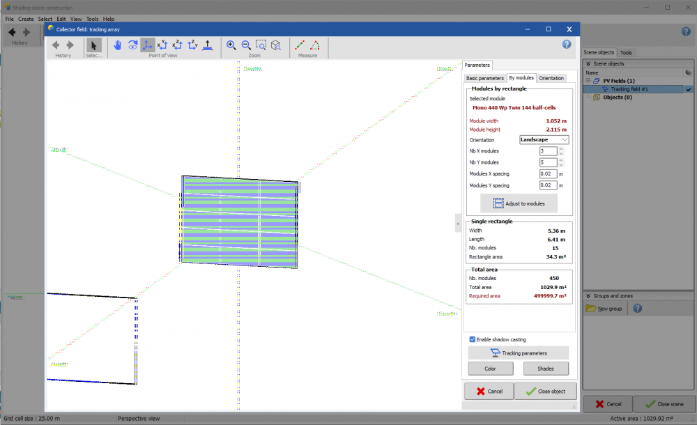

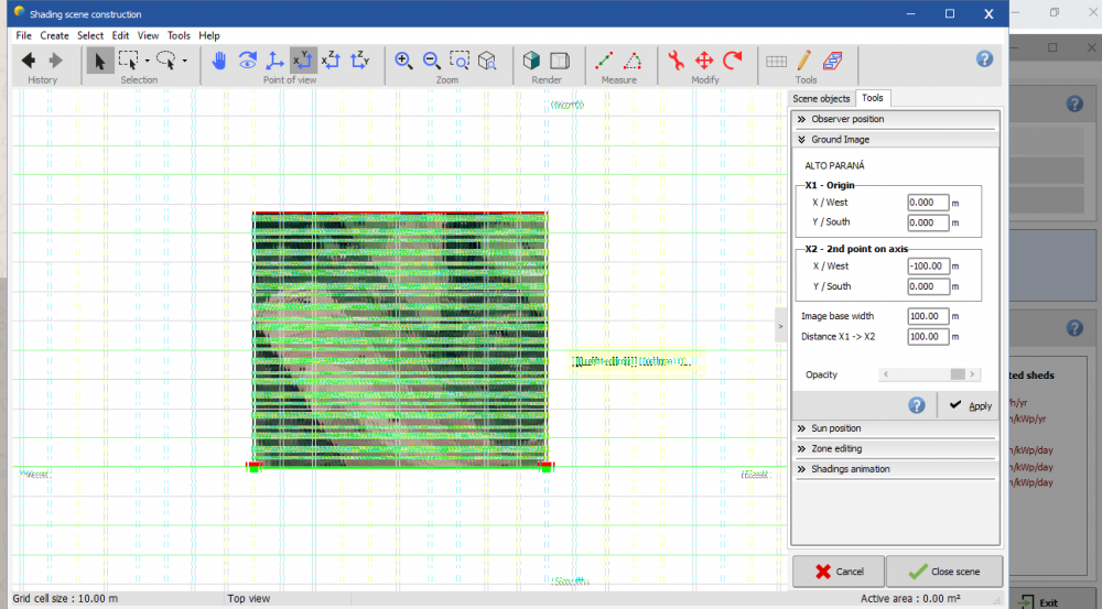

rgfranco Posted September 14, 2020 Posted September 14, 2020 Hello, I'm having the same issues.I´ve checked the updates and I don't have the one you mentioned (KB4497165) installed, however i'm encountering the same issue on the shading scene construction window...

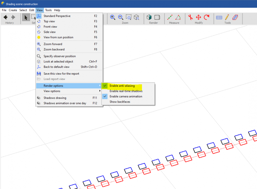

nfreiman Posted October 21, 2020 Posted October 21, 2020 Enabling AntiAliasing fixed the problem for me!

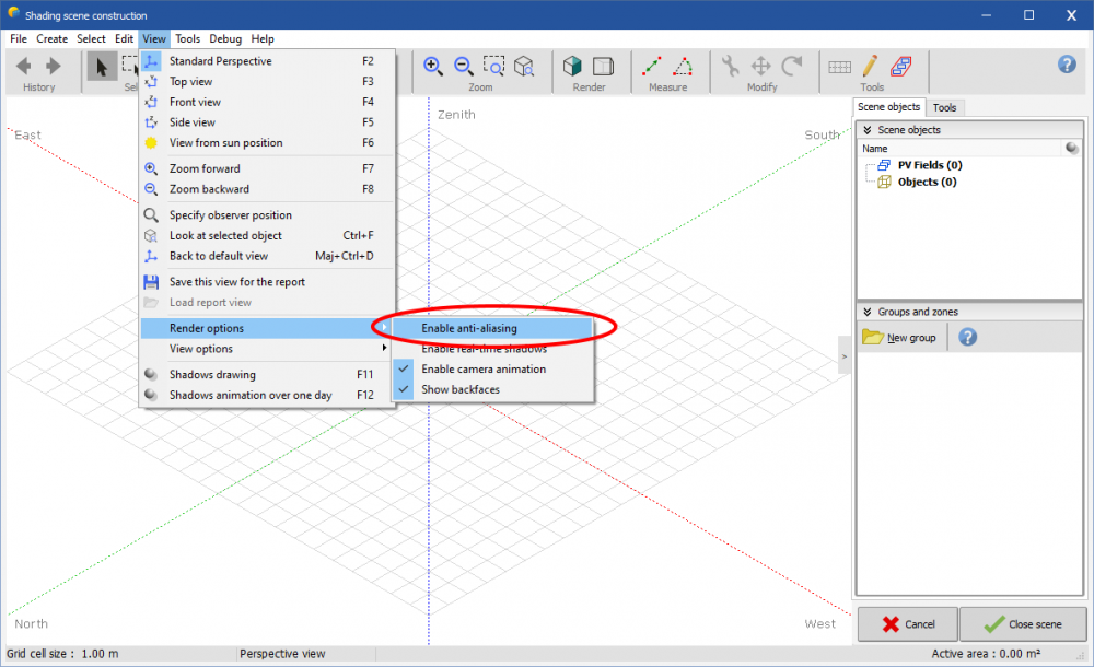

Stéphane Metz Posted November 5, 2020 Posted November 5, 2020 Hi,In order to fix the blur, you'll need to activate the anti-aliasing rendering option. Also remember to update your PVsyst to the latest version.
