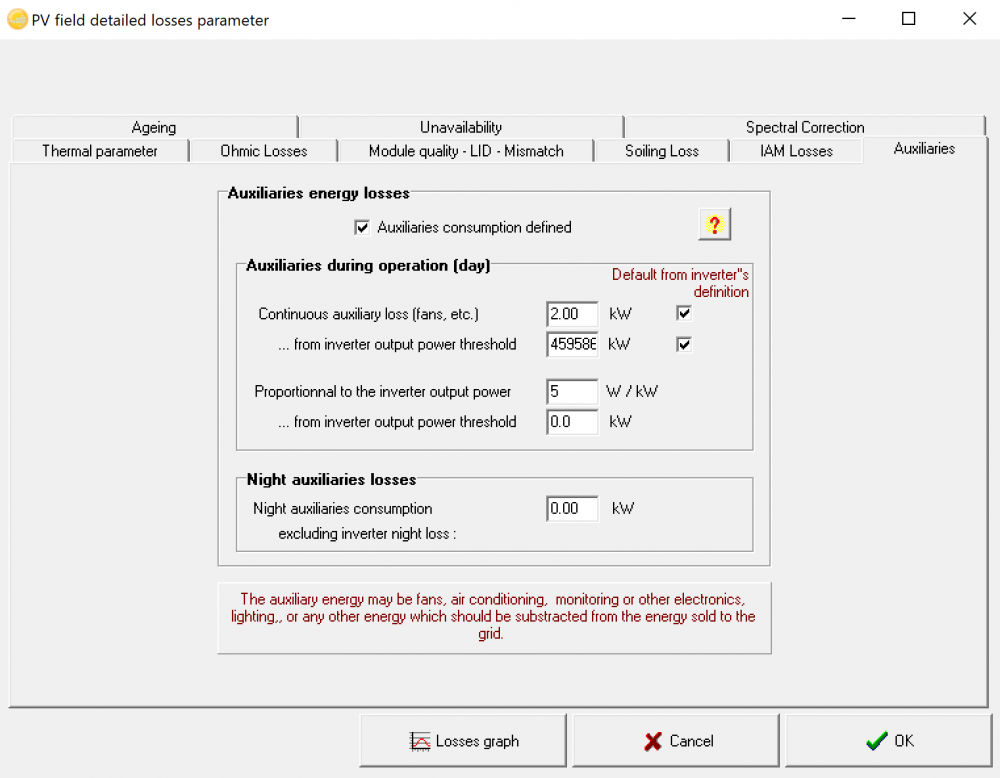

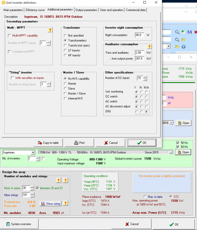

fredericr Posted February 8, 2019 Posted February 8, 2019 Hi PVsyst Support team,There seems to be a bug in V6.78 in System Losses Auxiliaries Tab when clicking the default checkbox to pull the Inverter Auxiliary loss into the System Loss.See below case where I have one inverter with 2 kW loss is power > 287kWThe loss is imported as 459586 kWInverter OND System Loss Tab
André Mermoud Posted February 15, 2019 Posted February 15, 2019 This problem has been corrected for the next version 6.79. In the meantime, please simply avoid using the checkBox "Default from inverter".
