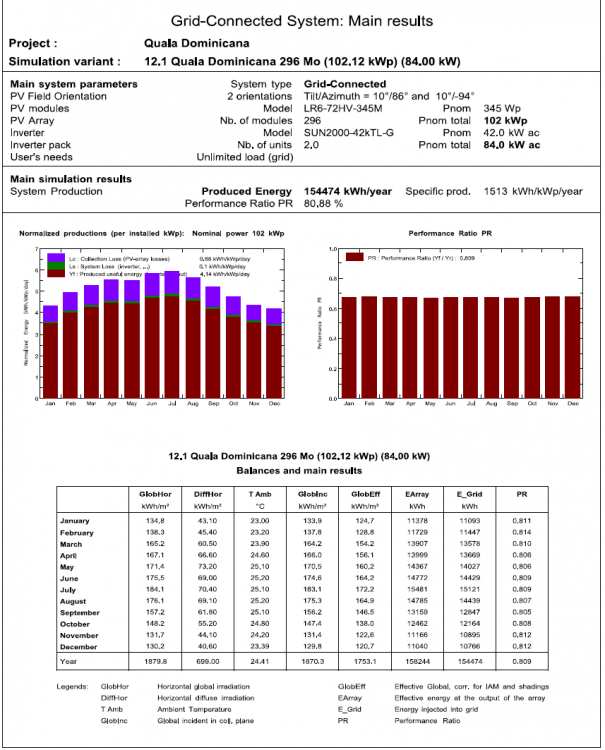

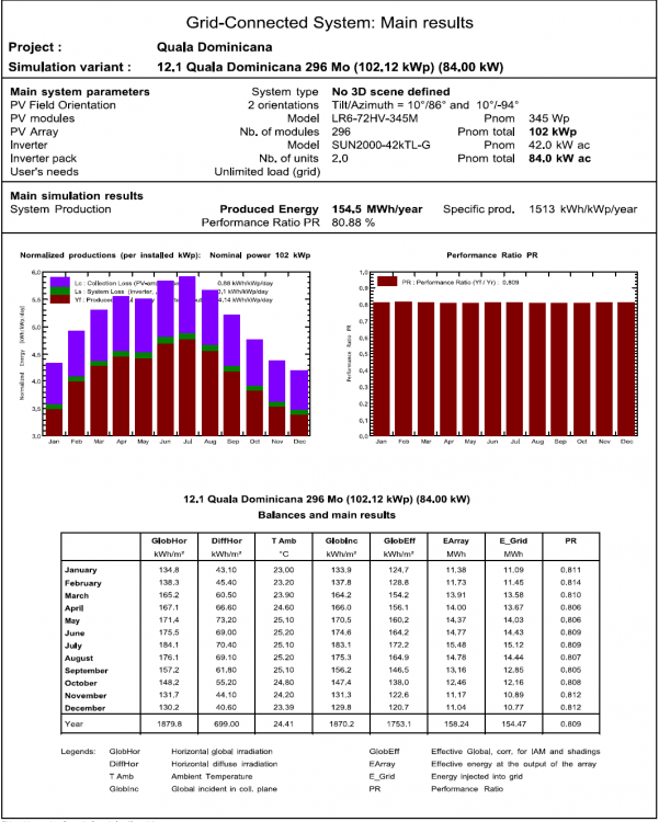

JasielSantana Posted May 3, 2018 Posted May 3, 2018 Hello.Yesterday i updated PVsyst to the last version and today i noticed that the Normalized productions Graph is displaying abnormally. Im attaching the report page of one same project with no modifications of any parameter. As you can see the report now is showing a scale from 3-6 on the Y axis, but before it showed from 0-7. I can change the graph parameters in the Predef. Graphs Tool but i dont know where to change it so it will show in the report document.Since this just happened after the update im thinking is so kind of bug.First report before the updateSame project after the update
JasielSantana Posted May 29, 2018 Author Posted May 29, 2018 The problem was solved after i updated today to version 6.73.
André Mermoud Posted June 2, 2018 Posted June 2, 2018 Yes, this is a problem of scale: the values are correct, but the drawing bars are not based on 0. This is corrected in the new version 6.73.
