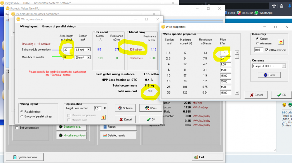

6.6.6 wiring losses calculation prices mistakes
Hi in 6.6.6 (win 10),
1.
detailed losses-- ohmic losses-- detailed computation..
it only calculates one string cost, not all the string costs. see attached image
same problem for inverters- only calcualtes cost for one inverter.
2. in "wire properties" "price" after I input all prices and close the view (or program) it messes up all the prices for next time.
specifically
a) deletes 50 and 70 mm prices and shifts other prices downwards (effectively changes everything to cheaper
b) if you write higher price to any of thinner wires, then it overrides all bigger wire prices to this higher price. (maybe this was though as feature, but it is annoying if you make mistake in editing and lose all previously edited prices because of this.
