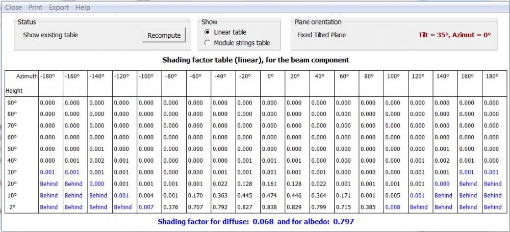

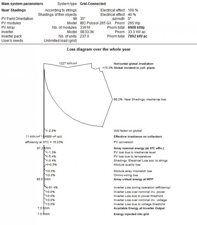

SE2015 Posted March 13, 2017 Posted March 13, 2017 Hi, in V6.60, my shading table looks OK, but the irradiance loss seems a tad high :-)
André Mermoud Posted April 8, 2017 Posted April 8, 2017 You are probably using SolarEdge optimizers with fractional inputs. There is a bug with these devices and this situation in the verson 6.60, which has been corrected in V 6.61.
