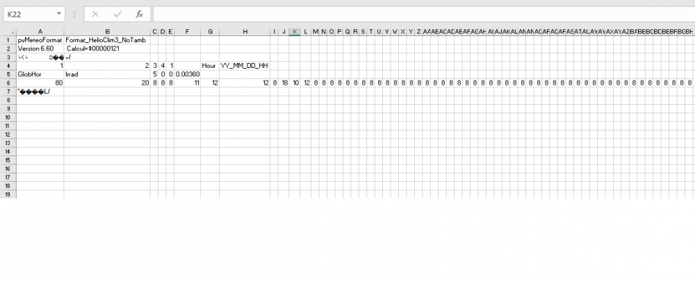

Thanks for your answer but the template attached is not the one I would need. It has not got the 8760 hours (for a year). Also, when I use semicolon separator, the result doesn't have sense. I attached the result.
How do I modify the data of the template?. Using excel, it is not ok, the result does not have sense. I attached the result.
So please, could you explain me again the steps to import to PVsyst 6.4.3 the data from HelioClim-3v5, from 01/01/2005 to 31/12/2005, with data in each hour (GHI and Temperature)
Thanks and Best Regards,
You have tried to open the Formatting file (*.MEF) instead of the HelioClim Data file. This is not correct.
The formatting file should be put in the \Meteo\ directory, and chosen using the comboBox "Format protocol file".
NB: HelioClim has perhaps changed their format.
However it seems that they now distribute their data also in the Standard PVsyst format. Please try to import these data using this option in "Import Meteo Data".
