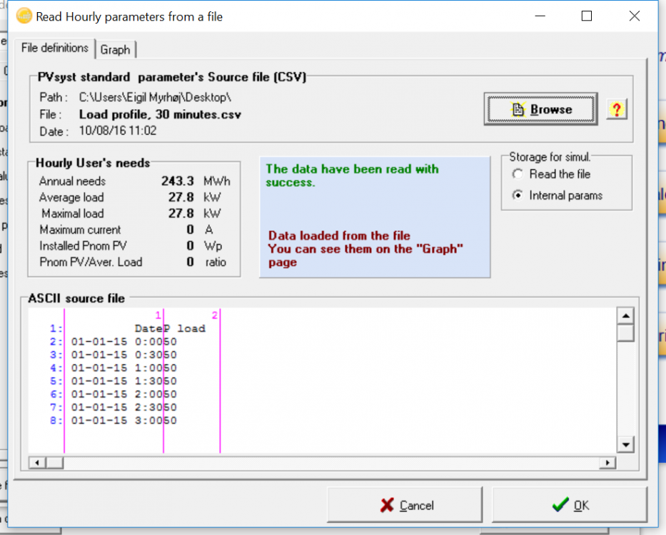

As I am not allowed to upload .csv or .xlsx files, I upload a screenshot of a 30 minute load profile example, which I have used for import evaluation.

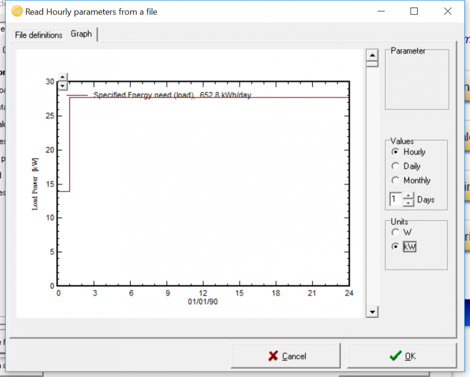

Screenshots from the import is attached and they show that the ASCII source file has valid data and that the first value in the file is not in the graph.
When I make 15 and 60 minute load profiles, the exact same problem occurs.
As you can see on the hourly user needs, the values computed in PVsyst are 3.6 times lower than the imported values.
What am I doing wrong?

Import graph showing missing first value from imported file

Showing imported values from ASCII Source file

Your file is not complete: the line for the unit definition, just after the Colunm's titles, is missing.
