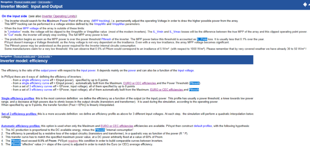

Energy production is based off the OND file, so your inverter will output at Pmax according to Tamb and there should not be any concern for operations in cooler climates. You can output the 8760 and verify this. As for reporting, I am not aware of any way to display Pmax over Pnom in the report. You can add under report options some notes and alternate system sizes for clarification, and also edit the cover page to include details there.
