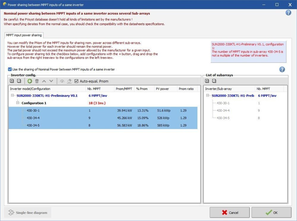

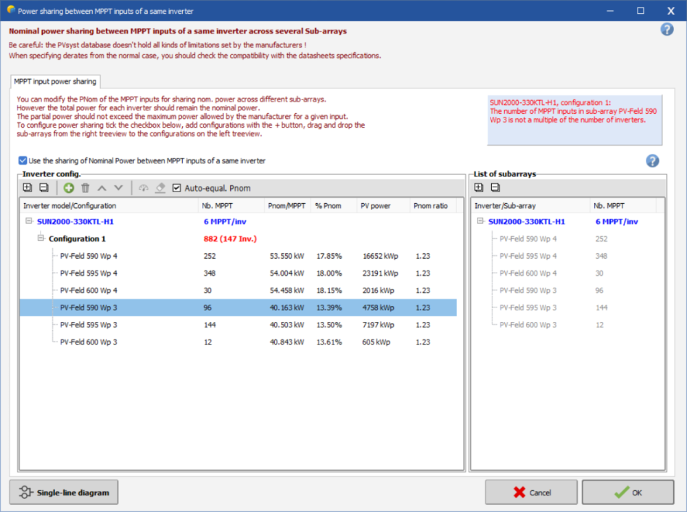

one remark: I ask myself, if it is realy necessary to pay attention that in each subfield the total number of MPP is a multiple of that of the inverter. In my opinion this criteria should be for the sum of MPPs of the sub-fields involved in power sharing. For the subfield it is more important, that the number of strings is a multiple of the MPP used in this subfield
I want to use power sharing between MPPT, because different numbers of strings are connected to the MPPT. I payed attention, that all MPPTs are used. Also I copied the additional configuration fromt the first to get sure, that I always use the same .ond file. Now I get the message, that the number of MPPT inputs is not a multiple of the number of inverters. Who could help? The configuration is: Compatibility between System defintions Full system orientation tilt/azim = 17° / 0° 3 sub-arrays PNom = 1163 kWp, modules area = 5280 m² No shading field defined in the 3D scene ! System parameters 3 sub-arrays defined Sub-array #1 430-30-1 PV modules: 4 strings of 30 modules in series, 120 total Pnom = 430 Wp PNom array = 52 kWp, area = 234 m² Inverters (300 kWac) 1 MPPT inputs, Total 50 kWac, Pnom ratio = 1.03 Sub-array #2 430-34-4 PV modules: 36 strings of 34 modules in series, 1224 total Pnom = 430 Wp PNom array = 526 kWp, area = 2390 m² Inverters (300 kWac) 9 MPPT inputs, Total 450 kWac, Pnom ratio = 1.17 Sub-array #3 430-34-5 PV modules: 40 strings of 34 modules in series, 1360 total Pnom = 430 Wp PNom array = 585 kWp, area = 2656 m² Inverters (300 kWac) 8 MPPT inputs, Total 400 kWac, Pnom ratio = 1.46 3D shadings parameter No shading scene defined

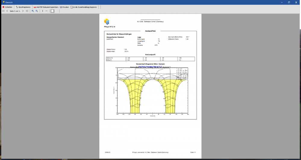

I am not able to print a valid horizon file

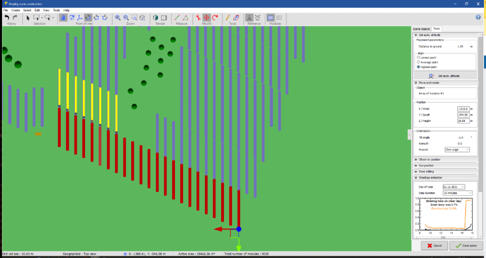

We have a surface that slopes 1.6° to the north. Single-axis trackers with a north-south axis should be installed on this surface. The arrangement of the trackers has a misalign. To map the field we use several tracker arrays. To align the trackers in the correct height we have defined a ground object that gets a tilt of -1.6°. We align the height of the trackers with Set auto. altitude. We now have some trackers in the field that are optically lower than the others, although mathematically the height in the coordinates was calculated correctly by PVSyst. Can someone help here?
