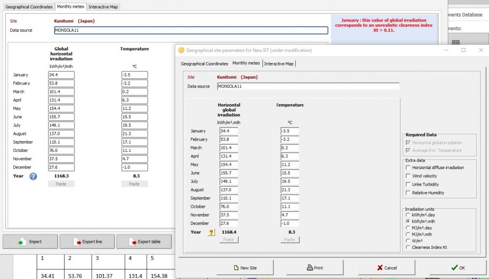

Hi, the image below shows meteo data I am inserting in version 7 vs version 6.87. For some reason I get a kt error in V7. Any thoughts as to why? is there a hidden parameter I can change to fix it? Thanks!
