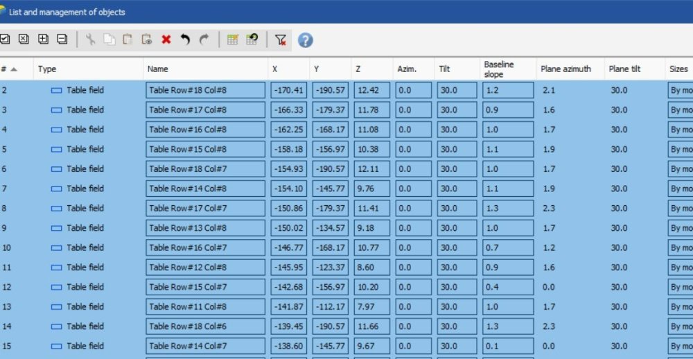

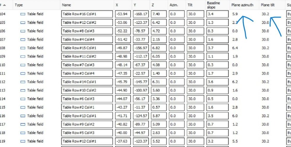

Yes I works with topography. The PVsyst aligned solar tables to the field surface based on the topo map, but in reality we will have all the tables with tilt 30 and azimuth 0 (we plan to design the support structures in this way). changed/aligned azimuth and tilt reduces electricity generation. -

Thank you for prompt reply. The box which I want to change is not editable, I click but is has no affect. Please see the attached file "Screenshot_1" where I indicated with arrow the field which I want to modify (Nominal-real tilt and azimuth). Nominal tilt and nominal azimuth has modification function, but I want the nominal tilt and nominal azimuth to be equal to real tilt and azimuth, That is why I want to change real tilt and azimuth. For example table filed #104 has plane azimuth 5.9 which has to be 0 and plane tilt is 30.2 which has to be 30.0. Thank you -

Thank you for the help. I have one more question. Is it possible to change "Plane Azimuth" and "Plane tilt" by editing ? Please see the attached screen where this data are not editable. -

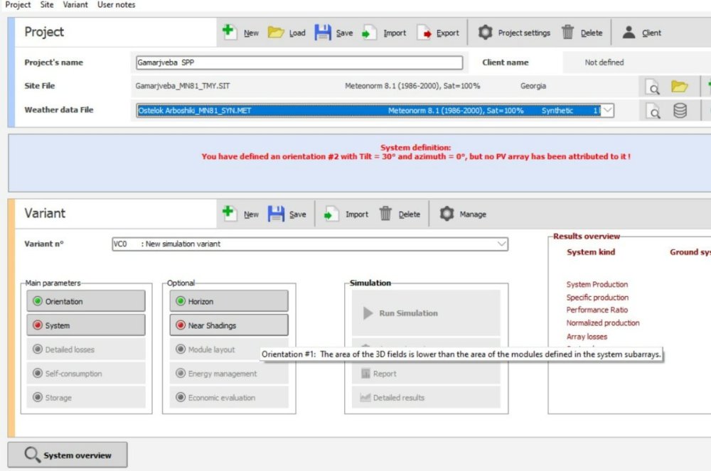

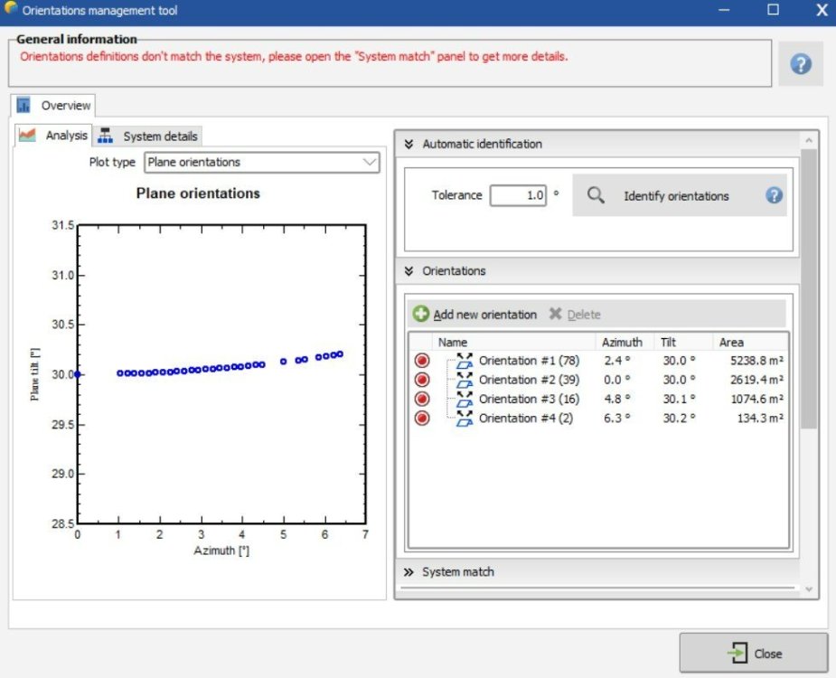

Hello, I imported PVC file from PVdesign successfully. In the "Near shading 3D scene" followed the following fields: "Shading field construction"-"Tools"-"Orientations Management", identified orientations (Result is attached, see file "Screenshot 1") and I received 4 different orientations. "Near shading 3D scene" page shows the following notification - "Orientation #1:"The area of the 3D field is lower than ......" (screen in attached, see file "Screenshot 2). Project first page screen is attached which shows mismatch between "System " and "Near Shading" (See attached file "Screenshot 3"). Can you please tell how to proceed? In forum page is written "After creating the orientations in the 3D scene (8 at most), you will have to harmonize them with those defined in the system and assign the subfields to these orientations", this may be the way but I can not find out how the subfields should be assigned to these orientation?
