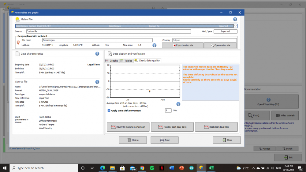

  4. Hello everybody I made a custom meteo file based on my own measurements. These measurements started on 20 july 2021, 9u25. In the picture below you can see in orange that the imported meteo data is shifted by -53 minutes, but i don't really understand how that is possible because i defined a 5 min time shift in the .MET file. Can anybody explain what the time shift is and why it is -53minutes here? Thanks, Emma
