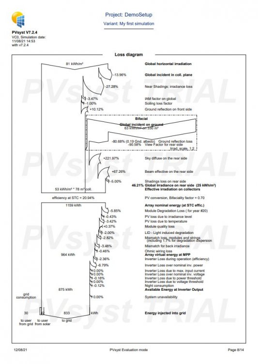

	Hi, Sorry for my late respons. Didn't receive an notification of your answer. I'm not able to upload my report files ( I don't know why?), so here are images of my project report: This is my file:

	Hello everyone I have currently created a PV project and run a simulation. However when analyzing the results of the simulation I noticed that my performance ratio has a value of 171%, which is basically impossible. The report of my project is in attached file. Could anyone help me? Kind regards Yoline
