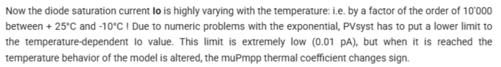

After posting this, I realized the documentation may be referring to the saturation current evaluated at the actual cell temp, rather than the reference value. Is that the case?
In PVsyst's documentation, it's stated that due to computational problems, PVsyst requires that the saturation current of a module at STC (I0_ref) be at least 0.01 pA, or 1e-14 A. However, after playing around with the single-diode parameters of modules in PVsyst, it seems like in reality the minimum saturation current of a module is 0.01 nA, or 1e-11 A. This is 1000 times greater than what is stated in the documentation. Is the value quoted in the documentation an error? Or is there something else going on here? Attached is a screenshot of the documentation text for reference.

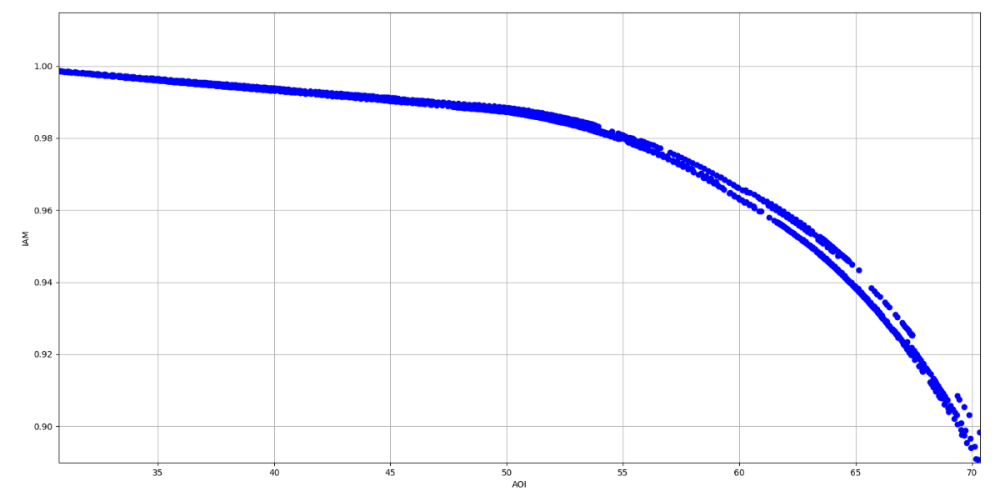

For anyone wondering, it appears that this bifurcation is a result of soiling, since it disappears when soiling is set to 0% for each month. That said, it is still a mystery to me exactly how soiling values are affecting IAM.
Recently, I calculated the IAM beam factors for each hour of a fixed-tilt 8760, as 1 - IAMBLss/(BeamInc - ShdBLss). The project was modeled in PVsyst 8.0.7 with the default parameter values for a Fresnel AR IAM curve. When I plotted IAM vs. AOI, I saw a curve that somewhat resembled the Fresnel curve - except that there were significant bifurcations. See the attached image. As far as I can tell, this seems to be a "feature" of PVsyst 8, as the same bifurcations do not exist when I run the project in 7.x.x. What is the reason for this? This seems to be non-ideal behavior.

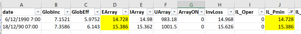

FYI I think this threshold loss is based on minimum current. Several simulations that I've run show a threshold loss below a certain minimum IArray. What that IArray is, however, remains a mystery. Just frustrating that PVsyst's behavior is unexpected and doesn't follow its own documentation. -
I ran a simulation and noticed that there are certain hours where the inverter is flagged as offline and the power loss is assigned to the "IL_Pmin" category, which is supposed to be because array power is below the threshold of the inverter. However in my case, for the hours that are lost due to inverter threshold, the input power is actually 5-6x the inverter threshold. This is sort of a "double whammy", because not only are those lost production hours, but there is also nighttime inverter loss associated with these hours. See the below example, in which an inverter with a 2500 W (2.5 kW) threshold is losing power. For reference, just a single central inverter (2200 kW) is being used for this project. Power units are in kW. Can someone explain why this is happening? The result is a lower yield than I would expect.
