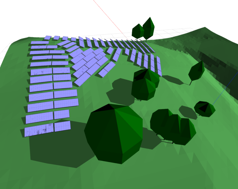

Need advice for complex shading scene
in Shadings and tracking
Posted
I have a multi-orientation PV system on a very curvy hillside, and I am struggling to model it successfully.
Using the automatic altitude tool, I end up with 60+ orientations which is obviously too many to reasonably distribute the strings across (and obviously the software only allows 8 anyway). Is there any best practice or easy method to overcome this? Or would I need to manually adjust the different groups of tables into just 8 pitch/azimuth combinations, and position them manually?
Any help/advice would be greatly appreciated. Please see screenshots attached.
