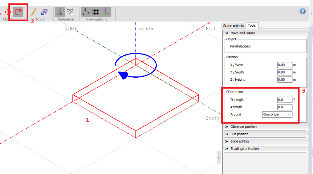

Dear Michalis, After adding the object to the 3D scene, you can select it, then click on rotate icon and set its tilt and azimuth as shown below: Regards
